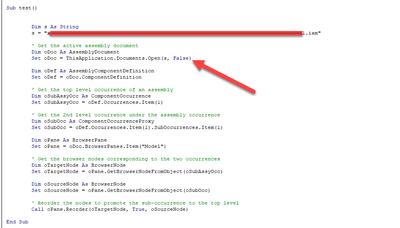

I have tried to promote the subcomponent of an assembly component.
It works if I open the visible document, but if it is hidden it doesn't.
Is there a reason?

mirkomaga
mhh, add(?)
Error is before.

post your code in txt
mirkomaga
Yes sorry
