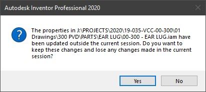

im having a bit of an issue with saving the iProperties through apprentice. With every process that adds an iproperty to a file, i am using m_oDocument.PropertySets.FlushToFile() which should be saving the changes on the document but after the process is complete and i manually go through the document, i still get the popup message
question is, if i am flushing to file, why am i still getting the popup and more importantly, how do i suppress it? I have looked for an ApprenticeDocumentSave but i cant see one. Im thinking it might be related to how i am setting this up so a little bit of guidance would be greatly appreciated. Below is what i am doing currently:

Looking at my code: i am iterating through an open top level assembly. Its visible to the user so its not an apprentice model. Then for each referenced document, i am declaring it as ApprenticeServerDocument. Directly underneasth that i am setting m_oDocument as an ApprenticeServerDocument.Open("") and this is the one i am flushing to file.
Questions:
  1. Do i need to set oRefDoc as an ApprenticeServerDocument and if i do, do i need to open the document or can i process by simply referencing it as above?
  2. Do i also need to set m_oDocument as an ApprenticeServerDocument if i an setting oRefDoc as the same? It appears that i am opening the document twice
What is the right way to approach the document reference as an apprentice document?
