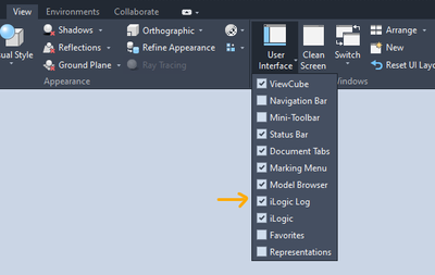

if you can enable your iLogic Log through
You can see the logs (as i included them in the ilogic rule) and a bit of what has happened.

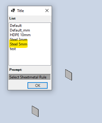

as an example of what happens when the sheetmetal rule is unavailable in one of the parts:
say, i selected "Steel 5mm" but this is only a local style (to the first part, "TEST copy.ipt") and only available to that part only
the log will show the active rule before changing, which is "Steel 3mm" and it successfully change it to "Steel 5mm"
but for "TEST.ipt", it errors as it cannot change to the "Steel 5mm" (as it is unavailable)
as opposed to say changing it to "HDPE 10mm" that is saved in the Library and accessible to all sheetmetal
Both "TEST copy.ipt" and "TEST.ipt" has been successfully change to the new sheetmetal rule selected

reine_den_andra
Hi!
I have tested this now. It's a bit strange. The box about which sheet metal rule you want opens up for each detail. In this case, 50 times in an assembly with subassemblies and parts 😁.
Even if the SAME part is in multiple places.
In a perfect world, I would wish that the first code I posted, @jnowel´s could take subassemblies.
