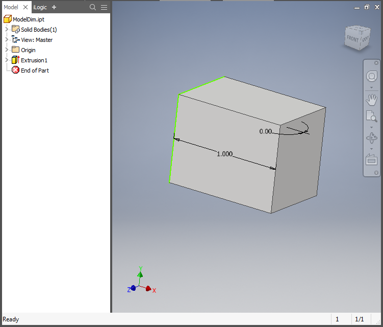

I created a simple sample, like in below document I created a simple extrude and show its feature dimensions:
and then create the 3D annotation for the linear feature dimension:
Below is the VBA code:
