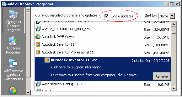

Message 11 of 11
Hi Jim,
I would have never figured out that one. Good job. I think the best
solution is to uninstall SP2 and reinstall it using the version you get from
the Autodesk website. You can uninstall service packs by using the "Add or
Remove Programs" utility and checking the "Show Updates" button at the top
of the dialog. This is shown in the attached image.
Brian Ekins
