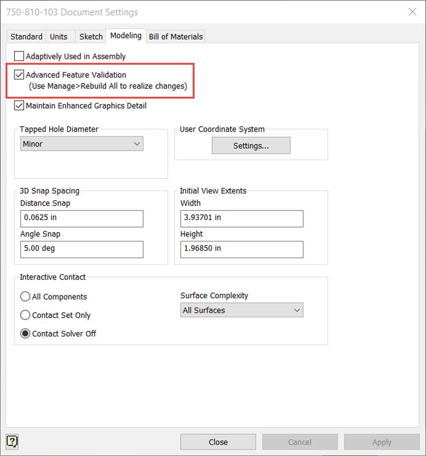

Hello all,
I'd like to request some help and I was directed here to see if someone would be able to create some code that would turn off the "Advanded Feature Validation" option. I've attached a screenshot to illustrate.
For whatever reason, this option is selected in all of our assembly files and it slows down the performace of those assemblies. I've manually been deselecting the option on every assembly that I've been working on but it's a tedious task that I would love to automate.
Ultimately it would be great to 'flip the switch' globally but whatever anyone can suggest would be greatly appreciated!
Thanks in advance for any help/ suggestions!
Best regards,
John

adam.nagy
Autodesk Support
Autodesk Support
Hi John,
You could add a code like this to the VBA module:
Sub SwitchOffAFV()
  Dim d As Document
  Set d = ThisApplication.ActiveDocument
  If d.ModelingSettings.AdvancedFeatureValidation Then
    d.ModelingSettings.AdvancedFeatureValidation = False
    d.Rebuild
  End If
End Sub
.. and a button for that command could be added onto the Ribbon from "Customize User Commands..."
That could save you a couple of clicks.
It could also be enhanced so that it's done for everyone document you open, or there could be a function that goes throgh all files in a specific folder and changes this setting for them.
Cheers,
Adam Nagy
Autodesk Platform Services

JohnKHouston
Thanks, Mike, for helping to add a button to run Adam's code, I really appreciate it!
Message 8 of 10
JohnKHouston
Hi Adam,
This routine works well but it does stop when it comes up against iParts and content center parts. Would it be possible to modify the code to ignore those components?
I'm guessing it's mostly because they're read only type parts but it's only a guess. Thanks in advance for your help.

Owner2229
Hi, you should look for the document's subtype:
If oRefDoc.SubType = "{4D29B490-49B2-11D0-93C3-7E0706000000}" _     ' Part proxy
Or oRefDoc.SubType = "{9C464203-9BAE-11D3-8BAD-0060B0CE6BB4}" Then  ' SheetMetal proxy
    ' Run the code
End If

Or you can place this at the start of the code (in the Sub Routine):
On Error Resume Next
Consider using "Accept as Solution" / "Kudos" if you find this helpful.
Regards,
Mike
"Always code as if the guy who ends up maintaining your code will be a violent psychopath who knows where you live." - John F. Woods
Message 10 of 10
JohnKHouston
The code, 'on error resume', worked. That's awesome, thank you very much!  😄
