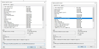

I have a problem with loading app on Inventor 2022.
Even though our app(MechClick) has not any difference comparing with 2021 and 2022, app is not loaded on Inventor 2022.
As you can see below, CLSID B4287DEA-12D8-4DB7-8FB7-BE31126AD4A5 is not existed on Inventor 2022.(registries)
Cannot find MechClick on Inventor 2022
Please let me know the solution to figure it out,
272 Views
1 Reply
Reply (1)
nmunro
Autodesk has placed further restrictions on registry based Inventor add-ins in Inventor 2022. You should convert your add-in to the manifest based registration method. More information is available at Retire Registry-based Add-ins in Inventor 2022 - Manufacturing DevBlog (typepad.com)
