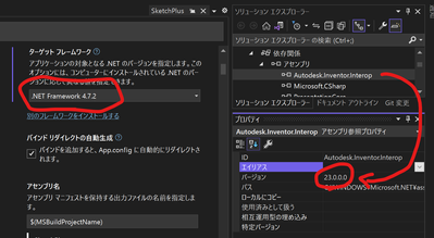

Message 19 of 22
HideoYamada
The problem may cause by the version incompatibilities of Autodesk.Inventor.Interop and/or .NET Framework.
Check the versions in your VisualStudio project and make sure the target PC supports these versions.
Freeradical
 Hideo Yamada
https://www.freeradical.jp
Message 20 of 22
HideoYamada
The picture in my previous post says that my add-in "SketchPlus" supports .NET Framework 4.7.2 or higher and Inventor 2019.0.0.0 or higher.
