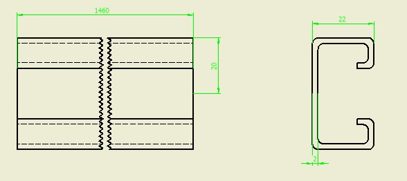

Would you please tell me how to add centerlines(symmetry axis)for the following views ?
Message 11 of 19
Aha,how are you going these days ? I'm sorry to cause  you trouble again . I have met with another kind of centerlines problems,that is symmetry axis .Woule please tell me the API to create symmetry axis ?I want to create the two  red horizonal centerlines in the figure attached .
Best wishes .
Message 12 of 19
Aha,I have found a way to get centerlines:

The last problem is that there are so many drawingcurves on the views that I don't know how to choose a special curve from them.For example,I don't know which curve is the 14th curve. Is there any good way to choose the curves needed ?
