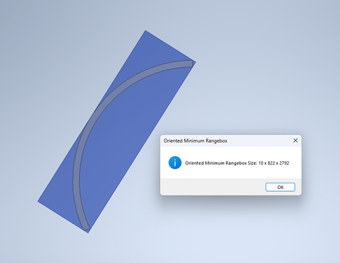

I shall try to explain my case, we are a small machine shop
we use Fusion 360 on the cam side.
when I do quotation to apart
I need to know how big the stock is going to be, to get the price on the stock and the material.
so this is the main purpose on the application.
on the stock we need to make it a little bit bigger.
so this is why I want to be able to adjust the size.
and I figure I don't need to do the work two times
that's why I want the solid to represent the stock.
so basically I do all the prep in Inventor
then I don't need to do the work again Fusion 360 when I pushed apart to Fusion.
this is what I come up with so far.
but in the picture you can see the blue but it is only a visual representation and I can't adjust it.
and here is the code

Message 4 of 14
JelteDeJong
does this work for you?

Dim margin1 = 1 ' cm
Dim margin2 = 1 ' cm
Dim margin3 = 1 ' cm
' Get the current Part document.
Dim partDoc As PartDocument = ThisDoc.Document
' Get the TransientBRep and TransientGeometry objects.
Dim transBRep As TransientBRep = ThisApplication.TransientBRep
Dim transGeom As TransientGeometry = ThisApplication.TransientGeometry
' Combine all bodies in Part into a single transient Surface Body.
Dim combinedBodies As SurfaceBody = Nothing
For Each surfBody As SurfaceBody In partDoc.ComponentDefinition.SurfaceBodies
    If combinedBodies Is Nothing Then
        combinedBodies = transBRep.Copy(surfBody)
    Else
        transBRep.DoBoolean(combinedBodies, surfBody, BooleanTypeEnum.kBooleanTypeUnion)
    End If
Next
' Get the oriented mininum range box of all bodies in Part.
' NOTE: "OrientedMinimumRangeBox" was added in Inventor 2020.3/2021.
Dim minBox As OrientedBox = combinedBodies.OrientedMinimumRangeBox
' Create starting box with dimensions of oriented rangebox.
Dim startBox As Box = transGeom.CreateBox()
Dim boxMaxPoint As Point = transGeom.CreatePoint(
    minBox.DirectionOne.Length + margin1,
    minBox.DirectionTwo.Length + margin2,
    minBox.DirectionThree.Length + margin3)
startBox.Extend(boxMaxPoint)
Dim boxMinPoint As Point = transGeom.CreatePoint(-margin1, -margin2, -margin3)
startBox.Extend(boxMinPoint)
' Create surface body for the range box.
Dim minBoxSurface As SurfaceBody = ThisApplication.TransientBRep.CreateSolidBlock(startBox)
' Create transformation matrix to move box to correct location/orientation.
Dim transMatrix As Matrix = ThisApplication.TransientGeometry.CreateMatrix
transMatrix.SetCoordinateSystem(
    minBox.CornerPoint,
    minBox.DirectionOne.AsUnitVector.AsVector,
    minBox.DirectionTwo.AsUnitVector.AsVector,
    minBox.DirectionThree.AsUnitVector.AsVector)
'Dim transMatrix2 As Matrix = ThisApplication.TransientGeometry.CreateMatrix
'transMatrix2.SetTranslation(transGeom.CreateVector(-margin, -margin, -margin))
'transMatrix.TransformBy(transMatrix2)
' Transform range box surface body to the correct location/orientation.
ThisApplication.TransientBRep.Transform(minBoxSurface, transMatrix)
' Create a base body feature of the result.
Dim nonParamFeatures As NonParametricBaseFeatures = partDoc.ComponentDefinition.Features.NonParametricBaseFeatures
Dim nonParamDef As NonParametricBaseFeatureDefinition = nonParamFeatures.CreateDefinition
Dim tObjs As TransientObjects = ThisApplication.TransientObjects
Dim objs As ObjectCollection = tObjs.CreateObjectCollection
objs.Add(minBoxSurface)
nonParamDef.BRepEntities = objs
nonParamDef.OutputType = BaseFeatureOutputTypeEnum.kSolidOutputType
nonParamFeatures.AddByDefinition(nonParamDef)
' Get length of each side of mininum range box.
Dim dir1 As Double = minBox.DirectionOne.Length
Dim dir2 As Double = minBox.DirectionTwo.Length
Dim dir3 As Double = minBox.DirectionThree.Length
' Convert lengths to document's length units.
Dim uom As UnitsOfMeasure = partDoc.UnitsOfMeasure
dir1 = uom.ConvertUnits(dir1, UnitsTypeEnum.kDatabaseLengthUnits, uom.LengthUnits)
dir2 = uom.ConvertUnits(dir2, UnitsTypeEnum.kDatabaseLengthUnits, uom.LengthUnits)
dir3 = uom.ConvertUnits(dir3, UnitsTypeEnum.kDatabaseLengthUnits, uom.LengthUnits)
' Sort lengths from smallest to largest.
Dim lengths As New List(Of Double) From {dir1, dir2, dir3}
lengths.Sort()
Dim minLength As Integer = lengths(0)
Dim midLength As Integer = lengths(1)
Dim maxLength As Integer = lengths(2)
' Display message with minimum rangebox size.
MessageBox.Show("Oriented Minimum Rangebox Size: " &
    minLength.ToString("#.###") & " x " & midLength.ToString("#.###") & " x " & maxLength.ToString("#.###"),
    "Oriented Minimum Rangebox", MessageBoxButtons.OK, MessageBoxIcon.Information)
iProperties.Value("Custom", "Material") = "Z" & minLength.ToString("#.###") + 5 & " Y" & midLength.ToString("#.###") + 5 & " X" & maxLength.ToString("#.###") + 5
iProperties.Value("Custom", "Min Material") = minLength.ToString("#.###") & " x " & midLength.ToString("#.###") & " x " & maxLength.ToString("#.###")
iProperties.Value("Custom", "X") = minLength.ToString("#.###")
iProperties.Value("Custom", "Y") = midLength.ToString("#.###")
iProperties.Value("Custom", "Z") = maxLength.ToString("#.###")

Message 7 of 14
kim.salvesen
Thank you very much it helps so much 😃

Victor.Tuguinay
Hi Jelte!
I am trying to use this "dynamic box" rule to get the overall dimensions of an irregular part and it works perfectly for that purpose. In addition to this, I wanted to detail the part and the oriented view shows that the points I arrowed to need to be horizontal so I can get dimensions as calculated by this "dynamic box" rule.
To do that, I came up with this rule that lets the user pick the drawing view and is supposed to let user pick the first and second points and will calculate the angle of rotation for the drawing view. However, it is not letting me pick the points. Can you please evaluate and maybe suggest a fix? Thank you in advance!
