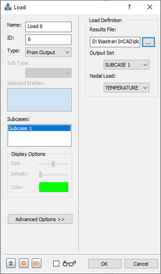

Inventor Nastran can apply loads to the current model using results from Autodesk CFD (pressure, temperature) or a different Inventor Nastran analysis (temperature). I would like the command to be expanded to support text files. This would allow results from other programs to be imported as loads into Inventor Nastran. (It could also be a new command instead of using "Loads > From Output".)

Current "Loads From Output" interface. Expanding the capability to allow importing results from a text file could be one option.
