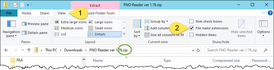

Recently I only tried to upgrade from .Net Framework to .Net core 8. Not sure if this messed up something in my computer, but I tested to open the .fno file from another computer with Inventor 2025 installed, and it worked. Anybody have any idea how to fix this issue?
Message 46 of 51
John_Holtz
Autodesk Support
Autodesk Support
Hi @IBuIBu
The folder "C:\Users\Ionel.bulancea\Downloads\FNO Reader ver 1.76" is a strange name. I think the real name is "C:\Users\Ionel.bulancea\Downloads\FNO Reader ver 1.76.zip" but Windows is hiding the names of the file extensions.
I suggest:
  1. Move the FNO file to a different folder, and do not put the FNO file inside a zip file/folder.
  2. Find the option in your File Explorer to show the file extensions. It looks like this on my computer (Win 10, a lot of fancy stuff turned off.) "View > Show/hide > File name extensions". When the file name extensions are shown, you will see the name of the "folder" is really ".zip". In other words, you placed the .fno file you are trying to open inside a zip file!
(edit: for some reason the image is not appearing in the forum. See the attached file.)
John

Message 47 of 51
IBuIBu
Thank you for your help, but this is not the case.
I have open the zip file already.
I tried to load the .fno file from multiple other locations .. and still the same error.
Is not that I don't have access to these folders ..
Message 48 of 51
John_Holtz
Autodesk Support
Autodesk Support
Thanks @IBuIBu . I do not think .NET Core 8 is related to the issue. I'm sure if you check the installed apps, you will see that .NET Framework is still installed.
Use Windows File Explorer to check the properties of the .FNO file. It the "Read-only" attribute checked? FNO Reader is opening the file in a binary format which allows reading and writing. If the file is marked as read-only, the open statement would not be able to write to the file and would give the error message you showed. (Files copied from other computers will sometimes be identified as "read only".)
If the problem is not "read-only", another question is whether Inventor is installed on the computer and still works.
John
John Holtz, P.E.
Global Product Support
Autodesk, Inc.
If not provided, indicate the version of Inventor Nastran you are using.
If the issue is related to a model, attach the model! See What files to provide when the model is needed.
Message 49 of 51
IBuIBu
You're right, the file was read only.
It works now.
Thank you!
