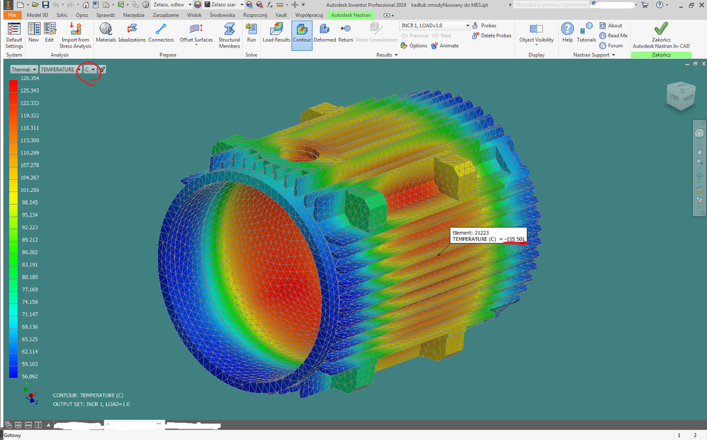

Nastran In-CAD thermal analysis
Conversion of displayed units from K to °C shows correct values on scale, but values on probes are wrong. It looks, like probes converts from Kelvin by subtracting ~273 twice, wich results in wrong values.
Units set to [K]:
Units set to [°C]:term2.png
706 Views
1 Reply
Reply (1)
John_Holtz
Autodesk Support
Autodesk Support
Hi @pbogucki
That problem is being looked at by the developers. If the testing goes okay, the fix will be released with version 2020 (due to be released at the end of March or early April, give or take).
