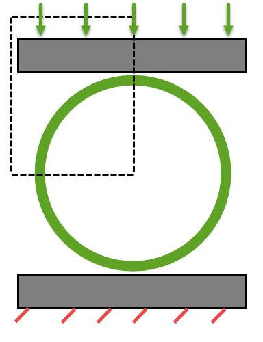

@John_Holtz  I have a question regarding that.
Let's say I have a hydraulic press and I want to compress a cylinder (no buckling).
If I only model the cylinder and apply the force on top (with the base fixed), it behaves as a distributed load and it forms a "parabolic" deformation on the top face.
This seems weird to me because (in the case of the press) it's not like there's a water column on top of the object, deforming and applying the same load as the object deforms.
If the middle starts to deform, it would lose contact with the press. So the press would apply a higher load on the edges, deforming them more, keeping things more as a plane than a paraboloid.
I'm not sure if this is true, but it makes sense to me.
So, how would I define a force as a "rigid plane" to compress the cylinder?
My solution would be to model another object with rigid properties (~infinite young's modulus, ~infinite yield strength) to act as the press and apply the load on top of it. But it's kinda clumsy, would there be a better solution?
I'm yet to do some tests to see what works best.
John_Holtz
Autodesk Support
Autodesk Support
Hi @delaroca
I believe your description is something like this, where the cylinder could be either a hollow tube or a solid cylinder. (The setup is the same, so that detail does not matter.)
This is a contact problem: the area of contact between the press and the cylinder changes depending on the load, so you are correct that you would need to model the press. A better load would be to apply an enforced motion because that is more statically stable, and one result of the analysis is what force is required to move the specified distance. But in theory you can also apply a force load.
Due to symmetry, I would model the 1/4 section shown by the dashed outline.
