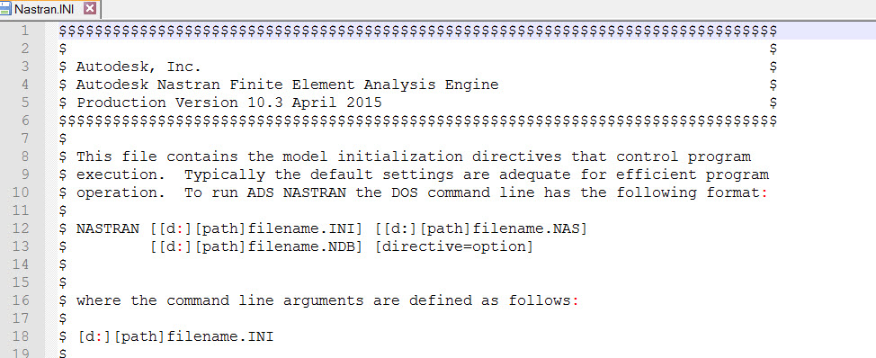

Could you give me an example of the rute change on this NASTRAN.INI file?
I have uploaded the .INI file.
Regards.
Andrew.Sartorelli
Hi Igor,
On line 85 you should see FILESPEC=C:\ProgramData\Autodesk\Nastran In-CAD 2016\Nastran\Temp, you can replace that with FILESPEC=C:\Users\iortiz\Documents\000_Scratch_CAE.
