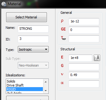

Material properties seem to be applied correctly through the idealizations. All my materials are steel, with the exception of some short "strong but light" elements to simulate rigid connector elements with the ability to release end nodes for rotations. Here are the properties I applied for those. Based on what you said, maybe I need to lower the elastic modulus here? I've used similar properties before without issues:

 I am going to refine the mesh a bit more, and also lower that elastic modulus in the "rigid" elements, and see if any of that helps. Will post back. If this next refinement doesn't work, I'll see if I can share a model file for further diagnostics. Thanks again for your help and suggestions!

I refined the mesh, which now contains just over 300,000 elements, only about .26% having jacobian below .1. Also, I corrected the Rigid material properties:
