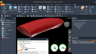

Some more related info:
Here is my simplest iLogic code to reproduce the issue on the sample .IPT I've mentioned in previous message:
Option Explicit On
Dim oPartDoc As PartDocument = ThisDoc.Document
Dim oPCD As ComponentDefinition = oPartDoc.ComponentDefinition
For Each oSk in oPCD.Sketches
	logger.info(oSk.Name & " - " & [Enum].GetName(GetType(ConstraintStatusEnum), oSk.ConstraintStatus))
Next
I would take this Issue for known-but-not-solved-yet-API-issue if Design Checker Add-In (with default settings) won't get things right.
From this picture you can see that Design Checker reports the "Slice" sketch "faulty" (UnderConstrained) while my iLogic code gets the Unknown ConstraintStatus value.

YuhanZhang
Hi @Maxim-CADman77
The sketch "Slice" in the legacy data is a derived sketch, so it should be in fully constrained status, but in UI it still indicates it needs dimensions, so I logged this as INVGEN-68532. You can provide the number to query its status.
