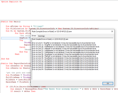

Hi @emanuel.c
Using "Option Explicit on" I see a few declarations are missing. These don't immediately indicate an error but without these declarations there can be unpredictable results.
Incorrect target Document:
With the logger switched on you can see an error occurring in every sub routine due to the rule targeting the launching document in this case an assembly file.
And again with new target document and  the logger switched on you can see  the rule is  targeting the  launching document in this case an assembly file.
Also the writing to excel error is due to opening the excel workbook in windows. This step isn't necessary as go excel function will open invisible and write to the excel workbook. If you need to  open the workbook do so  after it has been saved and closed.
Working rule:

Regards
Alan
emanuel.c
Wow you took the time to explain all that! Thank you so much! I keep learning a bit more each time.
A.Acheson
No problem at all, it is easier to post a few photos with the explanation of the debugging than trying to explain with words alone. Just remember those ilogic snippets are great in single document use but are not great when it comes to multiple document processing.
Regards
Alan
