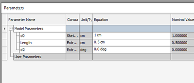

First, I have a part that has an extrude feature, and I renamed the value/parameter for distance A to "Length", as shown:

Thanks for your response, I can create the new parameter through ilogic because is a lot of parts, but how can I associate the new parameter to the extrude feature?
