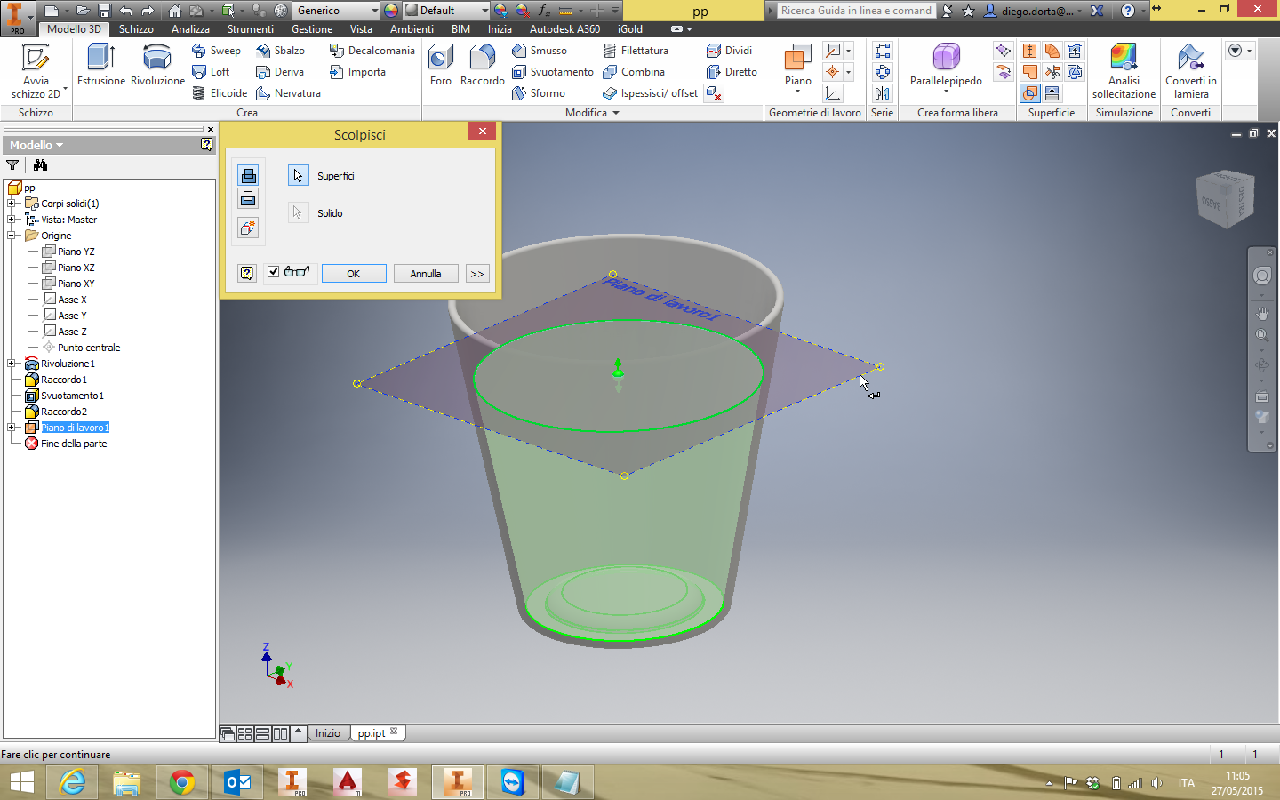

task:
getting a new solid using sculpt command between a plane/surface and the existing solid (for example to obtain a new solid to calculate the inner volume of a tank) .
actually when I use the sculpt command and select a plane (level of liquid) and the existing solid I can't select new solid in the options
what I can get is only the solid plus the volume between the solid itself and the plane.
the work around I use is to copy the solid as a surface than delete a face. in this case the sculpt between the plane and the surface will let me select the new solid option.
