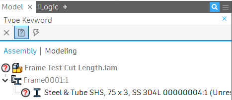

It would be nice when resolving links for missing parts if any are skipped the assembly would put the same symbol on the sub assemblies that have missing components in then. It currently puts the symbol on missing parts with a dark gray icon but nothing for assemblies and therefore you have to open them separately to find out which one has a problem.

Thanks for your feedback, the version you're using has the new search capability, have you tried the filter to search unresolved files? Refer to below ideas and the snapshot, it will help you to locate the unresolved components quickly.

DRoam
Hi River, sorry for the delay, thanks for seeking out our feedback!
I would say the original suggestion in this idea, combined with the suggestions in my comment on 4/2/18, would still be nice improvements to the unresolved files experience.
The original idea post is basically: When a file is unresolved within a subassembly, show an unresolved icon on the subassembly itself, so you can tell it has unresolved files in it somewhere. Ideally, the icon should also be added to other “containers” that would otherwise hide the unresolved component, such as patterns and browser folders. The advantage to this is you can tell where the unresolved files are immediately, without having to use the filter, which is faster in some assemblies (particularly smaller ones). It also has the advantage that you can see the unresolved files within the full, normal context of the browser tree. Sometimes when you filter down to only see one or two things, it becomes less obvious what those things are. Seeing the unresolved components in their original full context can be helpful.
Aside from that, I do think the suggestions in my comment on 4/2/18 would be helpful for discoverability. I’m unable to run Inventor at the moment to see which, if any, of these have already been implemented, so please let me know if any of them already have been!
Hope that’s helpful, thanks again for seeking our feedback, and let me know if you have any more questions.
