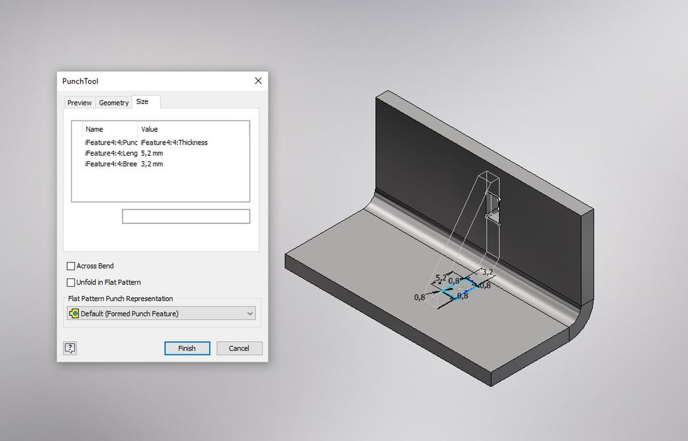

has anyone created an ifeature to mimic the tab and slot command in an assembly?
Yes we did some time ago actually.
We made two tools, not that hard to create. One for the female part and a tool for the male part.
It not only creates the square cutout/extrude but also adds holes to the inside corners.
(see attached pictures)
WGK - HEMI Retail solutionsMaleMaleFemaleFemale
