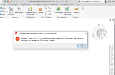

One other thing to try, rename the InvRO.exe file located in the "\Program Files\Autodesk\Inventor 2022\Bin" folder.

I have renamed C:\Program Files\Autodesk\Inventor 2020\Bin\InvRO.exe to InvRO-.exe
If this resolves the issue it would be very helpful.

subin.cletus
Dear @ihayesjr ,
After renaming the InvRO.exe
Today the following warning was displayed
On Opening files again from Vault  the file opened in Inventor Professional in place of Inventor RO.
I did not have to close Inventor Professional so the renaming works as InventorRO was not opened and hence not registered as the primary application for CAD files.
Subin.
