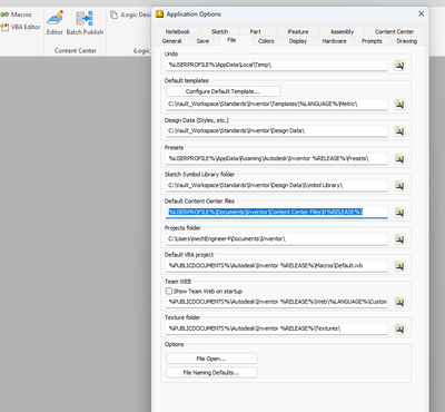

The OP is talking about this:
When Inventor is first installed, it sets the default content center path thus:
The problem lies in that part of this path is %USERPROFILE%.  This makes the path dependent on the user's windows login.  (Ignore the other settings.  This is not my real setup, I just made this image to demonstrate what the OP is talking about).
I have had trouble with this in the past, when I have had to log into another user's computer because I need files that they worked on, but they are not in the office.  I don't have their windows password to log into their account, so I have to log in under a guest account or whatever.  But when I try to open the file in Inventor, it can't find any of the CC files because it is looking in the wrong folder (again, because it is looking in a specific user folder).
Many users who don't understand project and library paths struggle with this.  It can cause lots of file resolution issues.  I agree with the OP that they should change the default path when Inventor is installed.  At the very least, set it to use the public windows profile, rather than a specific user.

Hi everyone. Is there way to change the default Content Center folder path in the application settings so that each time a new project is created, the Content Center files will be located in the project folder? Or is it possible to modify the default project file in the right way?
vjTR3QA
Below is my current location for content center files.
If I try and change the same to Vault workspace Below message is displayed. Can someone explain what is the problem?
