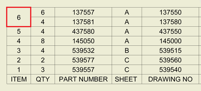

It would be beneficial when doing a drawing especially drawings for iAssemblies to have the ability to give parts in the iAssemblies the same Item Number (you currently can) and those Parts/Assembies with the same Item number to be merged into a Single Block as shown in the image below (Highlighted Red).
Merged Item

I actually Kudos that idea way back when. I must have forgotten it when I made this Idea. Yes I do hope it goes somewhere other than no where. I hope they revamp tables in general they could use a little work.
I've had to use iLogic to get what I needed.
I was disappointed that I couldn't get what I wanted with the Parts List but, we've adapted to the "new way" I've designed.
This is how I do it now:
The assemblies are shown horizontal (circled in red). Everything is populated and if changed, updated automatically.
The best part? A model doesn't have to exist in your .idw to populate properties in this intelligent list of material.
