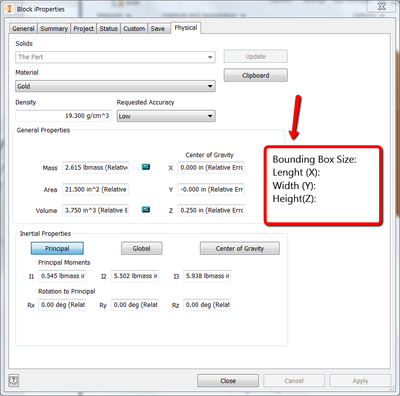

It would be really nice to have the bounding box or overall length (X), width (Y), and height (Z) values of a part or assembly file as iProperties without having to measure or do it as an iLogic code. Then, these could be properties shown in a drawing file in the title block or note.
This could be placed in the iProperties under the Physical tab:
