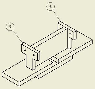

Hi all,
Inventor groups items by part number for example and gives a total QTY for the item as well as a single “Item Number”.
So for example duplicates of the same part will show in the Parts List under one Item number, showing the QTY of that specific part and then its properties like Part Number or Stock Code etc... So when you Balloon the assembly all the parts that are similar/duplicates will display the item number "1"
Example:
Please add a way to setup the parts list so that it allocates an item number per item that will still get grouped yet still be independent from the others of the same type.
Example Below
And then when Ballooning the parts of the assembly the similar/duplicate parts must have their own individual Item Numbers
I know it can all be changed manually by editing the values and overriding the Balloon Item Value etc... But when you have lots of parts in an Assembly its nice to have it update automatically when parts get added or removed and if you have multiple sheets.
I know that if I put a duplicate of a part in a assembly I can go change the name, Part Number etc to make it its own individual part and it will be displayed separately in the Parts List and given its own Item Number in the Parts List and when it gets ballooned, but my issue with this method is that when I modify the original part the other ones will not adjust accordingly and I can't always rely on modifying the copied parts and adding associative links and projected geometry etc.
Wian

@Anonymous, to clarify -- all of the instances of a given part ("Tbracket" for example) are the same Part file, correct? You simply want a unique balloon indicator for each instance? So that you can say to your colleague something like: "Tbracket Item 6 got broken out in the field", and they'll know which "Tbracket" you're talking about?
If so, that's why trying Paul's solution didn't work for you. Parts List "Grouping" will only group separate Parts List line items, and currently the only way to get separate line items is to have separate Part files. In other words, you would need each instance of a Part to be its own Part file. Which, for nearly all situations, is impractical.
This has been discussed a little before but didn't get much attention: Unique piping parts parts list. This user needed to do the same thing as you except he wanted to keep each instance (with its unique Item #) on its own Parts List line. But the premise is the same--both of you need the ability for each instance of a Part to be its own "line item" with its own Item #, and one of you (you) would group those into a single line, while the other (CADMonkey4Life) would leave them on separate lines.
So summing up, Inventor needs the new ability to assign an unique Item # to each instance of a Part in an Assembly. And the only way to do that right now is by saving each instance as a unique Part file, which is pretty much unrealistic. So for now, you're kind of screwed, until Autodesk adds that functionality.
That being said... there MIGHT be a way to use iLogic to re-number your BOM's Item #'s, and while doing so, identify if a Part has, say, 3 instances and then assign in the next 3 Item #s separated by commas, then continue. I think that's do-able. The hard part would be then overriding each Balloon label to be the correct number for each instance of each part. It might be possible.... but I'm not sure. But I think that's your only hope for an automated solution at this time.
