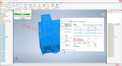

The top assembly containing 12304 components with "Treat subassemblies as components" turned on and an interference analysis took 16 minutes.
In this case, the CPU utilization was 20%.
If Inventor were able to perform the interference analysis in parallel on multiple cores, this process could be completed in as little as 3 minutes.
