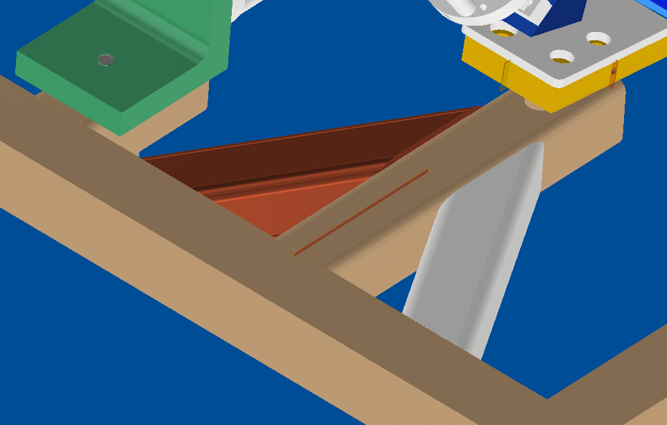

Long time listener, 1st time caller . . .
1)  How does one match properties in a part or assembly?  (I can do it with dims. in a drawing).  I am making a frame assembly from 2" square tube and I would like to have the complete frame be the same color.
2)  Where do I look to find the official color of a current part?  I did not see it in iProperties.
The included screen dump should help illustrate my dilemma.
