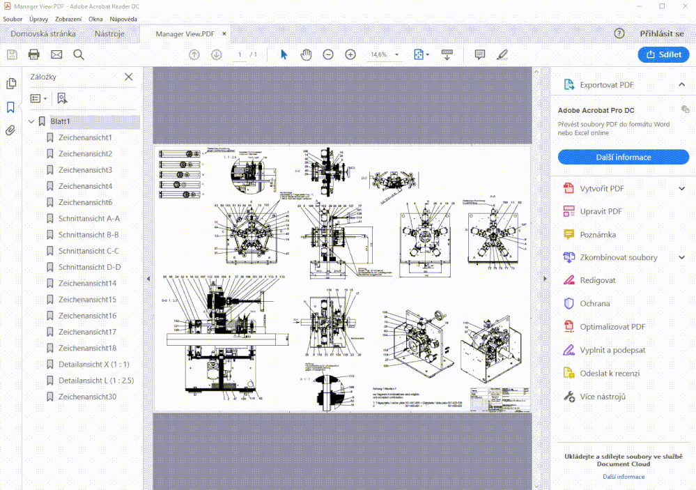

Functions like the gif for Inventor. Overview in views, details, cuts and positions. New export features for pdf. Switch between views in a drawing. You will no longer need to look for a position on a drawing. For production, clear. Production, customer finds everything. Keep your drawings under control. Put the balloon into the pdf
Functions for Inventor
We mark the sections as others will have a different character. When I cut C-C and D-D, then I delete C-C, so I will rename all sections only when using Progression. Ability to connect to the Bill of Materials.
