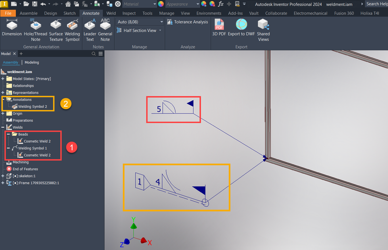

I was looking for a solution to get information from the Welding Symbol(1) in the Weldment .iam - it's not possible.
We can get information from 3D annotations for Welding Symbol(2), but it is not linked to the Cosmetic Weld(1).
I suggest linking 3D annotations(2) with the Cosmetic Weld(1) in order to be able to obtain additional information (for example - length of the weld).
Alternative: Getting information via API from Welding Symbol(1) in the Weldment .iam.
Please support the idea.
