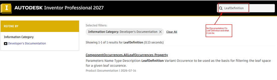

The argument LeafDefinition can be a PartComponentDefinition, AssemblyComponentDefinition, SheetMetalComponentDefinition, WeldmentComponentDefinition or VirtualComponentDefinition. There is not a specific API object for LeafDefinition, I will update the documentation for this to make it clear.
