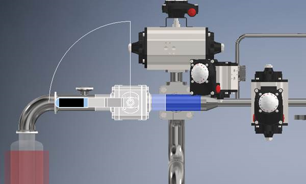

Tube and pipe requires a minimum pipe length between two fittings (bends, tees valves etc). Our systems have compact manifolds and more often than not there would be no straight lengths of pipe between fittings. I have set the minimum distance between fittings to 0.001mm to minimise the impact of this, however there is no method of cutting back two fittings to make them tighter together. See below an example of how some of our systems can look and how fittings are cut back when not using tube & pipe.
The minimum segment rule removes the creative freedom from the designer and becomes over-constraining, ultimately it should be the users decision to assess what can and cant be designed in the real world, not the computers.
