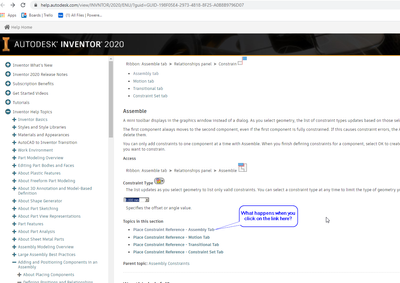

More and more I think that there is no point in writing here. For the desire to have a profit always spoils the whole business. The online guide is informatively dull ****. Here is a specific picture. Three kinds of solution in this type of connection. It's hard to see how it works on icons. There is not a word about them in the online manual when you click on the question icon. When you select one of the solution types in the main window, nothing visually changes either. Developed you are lamers. You don't give a **** about how the user perceives the product. I have been dealing with this product since its fourth version. And I want to notice the interface is getting worse and worse. You abandoned its original ideology and went to Microsoft. It's sad.

It may help you to enable constraint previews.
It may help you to click on the links in the help file.
I get the following page:
I would prefer that the help icon would take a user straight to the help for the active tab, not the parent command.

I didn't mean it, dear. I said that the skinny green arrows themselves are poorly visible. And often on a complex assembly it is not visible in which direction they are directed

Hello @andrei.gorbachev,
Have you tried using a more bold colour scheme... You can customize the arrow colours and make them very different to make them more apparent.
Hope this helps.
andrei.gorbachev
Thank you. I'll try to play with it when I have free time.
