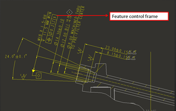

When attaching a feature control frame to a dimension, the frame can only be aligned in a center-justified manner.  Depending on the length of the dimension, this can look look unusual (at best) or obscure other objects (at worst).  Nearly every FCF that I see on other drawings in industry is right- or left-justified against the dimension text and leader line.
I would like to see the frame intelligently justify itself based on the dimension snap point that the user selected.  This would allow the existing behavior to persist, for those who require it, but permit consistent justification in the same way that multi-line hole notes and leader text are displayed.
My current workaround is to place the FCF elsewhere on the screen and manually drag it below the dimension.  Of course, the FCF is no longer attached to the dimension, and the vertical spacing has to be eyeballed every time.
Attached is a picture that illustrates the behavior.

Is it possible to align a Feature Control Frame to an edge that is not a zero or 90 degrees?  I have yet to find a way to move the FCF off of being horizontal.
In the image attached, you can see the surface texture symblol aligned with the edge.  I'd like to do the same thing with a Feature Control Frame.  Or does Y14.5M-1994 not allow this???

Your suggestion works, but the FCF will do one of two things:
1.  If the FCF has already been attached to the dimension, a leader line will appear when the FCF is dragged far enough away from the dimension.  This not only looks ridiculous, but seems to be in violation of Section 3.5(b) of Y14.5-2009, which states that leader lines coming from an FCF point to the feature itself.  (I understand that not everyone uses that standard, but since it's one of the most prevalent, adherence to the spec would be helpful).  See below:
2.  If the FCF has been placed in open space and isn't attached to the dimension, it can be moved around as suggested, but it won't move relative to the dimension.  So, if I manually place an FCF under a dimension and then decide to drag the dimension elsewhere, the FCF won't follow it.

What version of IV are you running?  I have 2016 and can't get the FCF to slide when it's attached to the bottom center alignment dot.  It stays put and eventually a horizontal line will appear if I move the cursor far enough over (figure 1 below).  If I pull downward, I'll get a leader as shown above.
I see what you mean about snapping to the end of the dimension.  This can get a little cumbersome with long callouts, though (figure 2).

I was able to reproduce the snapping behavior you described.  For me, though, I need to select a random location "somewhere near" the dimension when placing the FCF.  If I click a green alignment dot, it doesn't work.  After filling out the FCF dialog, the frame will then snap to the dimension text.  It can be dragged left, right, or center.  The workflow here seems really ambiguous.
Even so, and this might be splitting hairs, the FCF still isn't aligned correctly with the dimension text.  See below.

I too am using 2016 and am still having the problem.  Prior to 2016, I could shift the alignment of the FCF by dragging left or right.  Now when you try to drag it, it just pulls a straight line out, without moving the FCF, as shown above in fig. 1b.  When working in an existing drawing, the FCF's that already exist allow you to pull and they move, new ones added do not.  Has any body found a fix for this?  I can't even get the alignment like shown directly above (with the FCF aligning with the leader line).  I was hoping by now that this would have been fixed or answered, but I cannot seem to find it anywhere...and I have been looking for the better part of a year now.  Thanks in advance.

I can duplicate the behavior you described in 2016, too. However, I've found a workaround. The FCF will not allow pulling and dragging while snapped unless it's pulled off as a leader line first, and then snapped back. This has to be a bug.
The workflow is this:
  1. Attach FCF to bottom middle green dot under a dimension.
  2. After the FCF is placed, pull it off so there's a leader line pointing to the dimension (which looks goofy).
  3. Drag the FCF back under the dimension, which should make the leader line disappear.
  4. Drag the FCF left or right to snap as needed.
In addition, if you click one of the left- or right-justified green dots in Step 1, the FCF will snap inline with the dimension text. At that point, all bets are off in terms of alignment. It needs to go to the middle dot.
