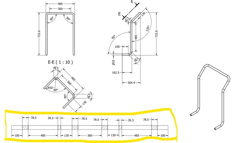

Please Create New Function Round Bar Unfold. I can create a Flat Pattern for Round Bar, but it's not a program functionality. The customer wants the functionality to unfold for the rod, maybe it would be good to unfold the tube.
File attachment.

There is a way to get a flat pattern of a round pipe or square/rectangular tube.  It's somewhat automated.
  1. Create an ipt and derive the formed tube or pipe into that ipt.
  2. Create a sketch on what I'll say is the midplane of the part.  Essentially on the left view in your IDW attached.  It works to do the top or bottom of the part as well.
  3. Project the outside profile of that pipe to this sketch.
  4. Extrude that sketch the diameter of the part.  So essentially your creating a square edged version of formed view.
  5. Set you SheetMetal default material to the thickness of that pipe (the diameter)
  6. Select what would be the inside face of the bend.
  7. Click the Create Flat Pattern command you should have a flat pattern.
It's tough to predict the bend length and K factor of a Tube or Pipe, so for us it's usally a K factor of .44 for us then we prototypem and if we have to tweak the K factor to tweak the flat length we'll do so.
It's not perfect but it's a fairly automated flat pattern.  It's a starting point.
Good Luck!

This function will be useful not only for round bar but also for tubes because now in our manufactory we have to do "flats" by hand: drawing separate lines, hatching arc places and add adding overwritten dimensions. Earlier mentioned work flow with sheet metal is useful only with rods but for me its really stupid to do two separate files and etc. Everything could be created with skeleton and weldments, where you already putting radiuses, tube diameters and there is no K-factor for tube bending. For now we waited minimum 3 years for this function, maybe plius more 3 years and then something will happen. Even Solidworks doesn't have this so Inventor will be ahead.
