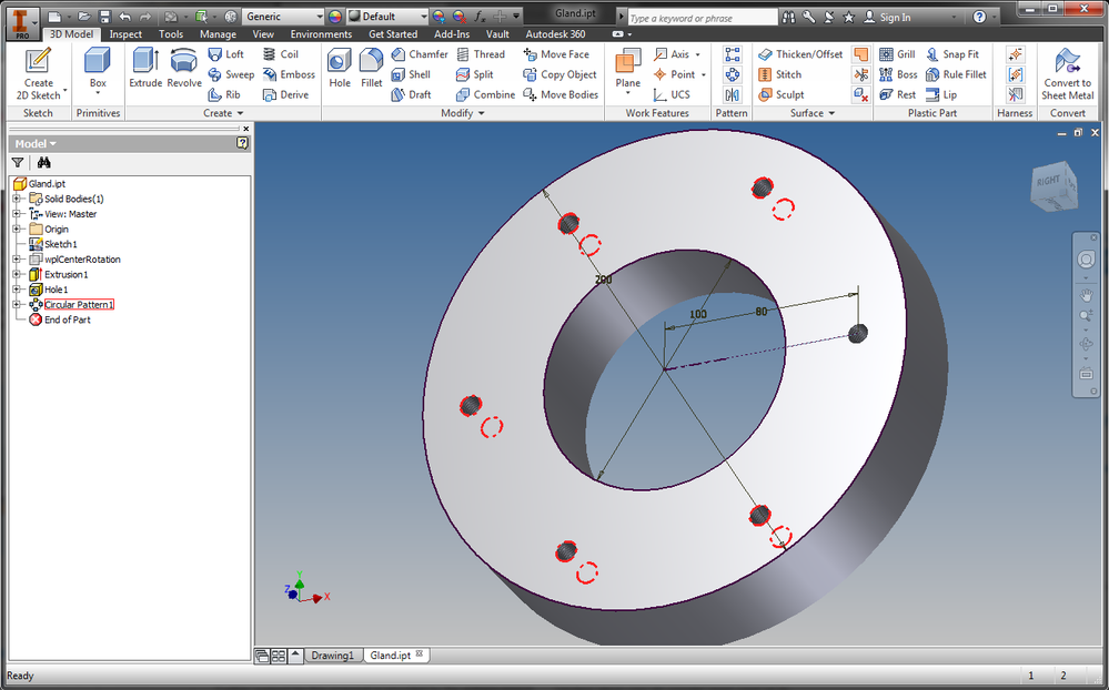

I would like to have a more intelligent Hole and Thread annotation, it would be very useful if it could collect more data from the Model (IPT), like for example the Bolt Circle and depending on the situation the angle of the hole location. This data should be available when a pattern has been used to create the holes.

Would be nice to have this as additional functionality of the Hole feature, and include that in the hole annotation. Not only for patterned holes.
