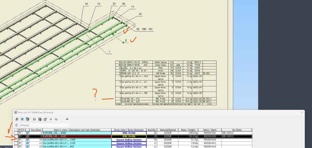

Hello.
It would be great to Highlight Parts List item when selected in Parts List.
Currently if you click the item on the drawing Parts List, it highlights it properly, but if you open Parts List on drawing and select the item, it is mostly selected, but not highlighted in Parts List table on drawing.
See attached images for clarification.

@ReneRepina when investigating on this idea, the top question is that how we cross highlight row between part list dialog and part list table on the sheet when some changes are made in part list dialog, e.g. reorder the position of row, group the rows etc.. You know it is not matching now between part list dialog and part list table on the sheet before clicking Apply button. Could you have some comments here? What's behavior you expect? Many thanks!

You probably have some ID in the back code, since you already highlight all the same entities in the drawing views (edges, balloons, ...) and even if you change the number or rearrange it, it still properly highlights the entities. So here I would say to apply the same logic to highlight the parts list table row, same as you have for other entities. Even if you have "old" data (before apply), it is enough that proper enitites are highlighted.
