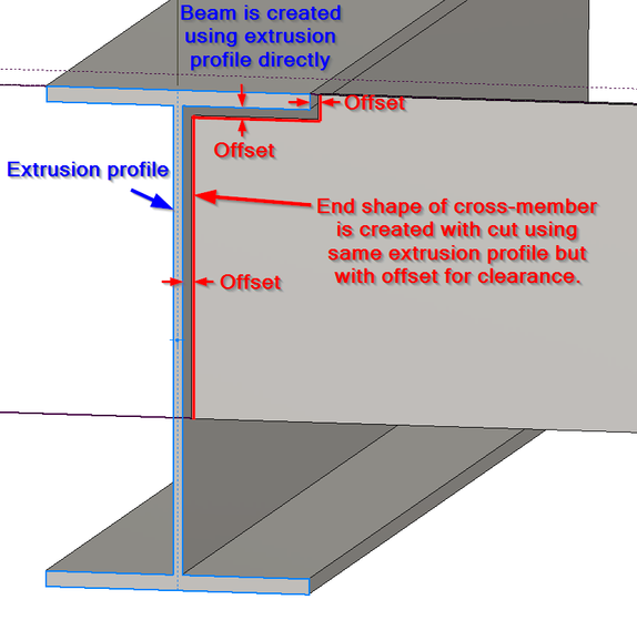

A profile in a sketch often actually represents two mating objects, such as a shaft and a hole, or a cavity and a mold, or (as in the image above) a structural beam and an intersecting member that copes to it. Currently, if those two parts need to have some clearance between them, we have to create an offset profile in the sketch. For complex shapes, such as cavities and molds or structural beams, this adds a lot of extra complexity and crisscrossing lines to the sketch.
It would be much simpler if we could just specify an offset when extruding a sketch profile, to either inset or extend the shape of the profile by some specified value. The specified offset value would result in a clearance between a part extruded directly from the profile, and another part CUT by the profile but with an offset of the desired clearance, like in the image above.

I work in the sheet metal industry and constantly create "tabs" on one end of a sheet metal part that will fit inside a cutout on a mating part to aid alignment for welders etc.  The way I do this is to create the tab (the male), then by creating a sketch on the mating (female) part, project cut edges onto the female part.  I then use the offset tool to offset the projected lines by +0.2mm to create a small amount of clearance to aid slotting part one into the mating part.  This can be very time consuming and ideally I would love to be able to cut the firstly projected lines with an offset built into the cut/extrude function.

I could see this being really useful... the problem with the Sketch "Offset" tool is if the original profile changes (i.e. curves are added, extensions are added or removed, etc.), then the offset becomes a mess and will probably result in a broken profile, and therefore a broken extrusion.
But if we could just define an offset from the extrusion profile, whatever its shape is, from within the Extrude command itself, then even if the original profile changes drastically, as long as it's still closed, the offset extrusion will be OK.
