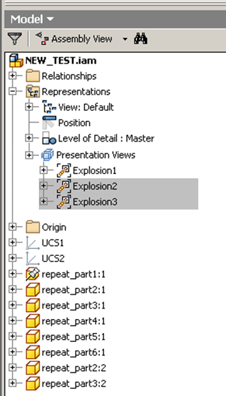

JoeBarnes4076
This could be a huge time saver and get people to use it more.  Some users avoid using because of the extra file to manage and reference.  Presentations should be just another sub-node in the representations folder
undefined
danmachen
@JoeBarnes4076 - Nice work on the model tree suggestion. I think this would be a welcome addition.
I have also noted that using vault & Inventor rename functions seems to not work correctly with some ipn files.
If they incorporated this functionality into the 'presentation views' as you suggest it would be great and save us that extra file to manage and uprevise.
