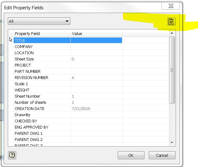

Currently, if a Title Block references iProperties of the drawing file and/or the model file, the user often has to do some digging to figure out where to go to update the information if it is empty or needs updating. Most often this gets discovered at the drawing level, and the then user must open the model again, etc.
It would be great if we could right-click on the Title Block and update the referenced iProperties (where ever they are). Something similar to these images, but be able to actually edit the fields that iproperties.

Note that this button takes you to the properties of the drawing only, and it takes you to all iProperties.
