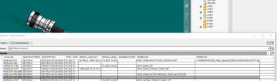

This is a huge issue for our company. We have spent a great deal of time and money to build a database of parts that conform to our standards, part of which is the assigning of inventor pins embedded, lengths etcetera. apl part.JPG
We are currently forced to insert our "Approved parts library" files manually in order to maintain the link to the proper location. Then assign the part a link from the location view. assign manually.JPG
The real issue here is that we typically have a electrical engineer create the schematic focused on the operation of the circuit and checking to make sure the final assembly will work. Once we pass that information on to Inventor we typically have a designer doing the work needed to build the housings, etc. The designer does not know nor should he need to know what wire goes where, if he could use the insert from catalog browser. This feature would allow us to simple right click, pick the part, and know we have the right component with the correct wires connected. (extra critical when the same connector is used in multiple locations.  Not having this functionality leaves or designers prone to mistakes when manually assigning.
To me if i map the location of the file, in the symbol3d field, in the electrical catalog, to where my model is saved it should use that file and location. It should not copy it and put it somewhere else.electrical catalog.JPG

Moreover, we use a single Vault Project that has '$/Designs' as Workspace and '$/Libraries/Electrical Components' as Library mapped in IPJ file. If we point the Catalog Browser 'SYMBOL3D' column value to an existing file in our Libraries folder and save, the Inventor Catalog Browser shows the 3D thumbnail when hovering over to place, and placing command seems to behave correctly... but when trying to check-in, instead of re-using the existing component we set in the Catalog 'SYMBOL3D' ('$/Libraries/Electrical Components/...'), it creates a new duplicate in '$/Designs/Electrical Components'.
I though I might change the location of the 'Electrical Components' folder, and move it inside the 'Designs' folder '$/Designs/Electrical Components'... but soon as the folder stops being a Library folder, it does not work anymore... as soon as we update the 'SYMBOL3D' column in the Electrical Catalog Browser, then 3D Thumbnail icon is NOT there... and place from Catalog Browser does not work as expected, it ask you to browse locally for the file (not even Open from Vault option).
So there is no point to the shared catalogue database (.mdb) and there is no real Vault integration here either... Unable to browse Vault for 'SYMBOL3D' or when placing from Catalog Browser.
