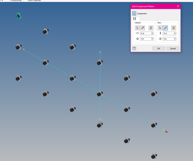

This is currently a feature in 2017 at least. If you right click the component pattern go to component and then demote... The issue shown below comes when you have a part or an assembly that you have used to dictate the direction of the pattern but did not demote it. This is easily fixed by using an axis to dictate the direction...

I have uploaded the dataset to the OneDrive site. The parts that I am having issues demoting are patterned along the edges of the part in the assembly named Lvl_15. The screenshot below is the names of the parts that are patterned as well as some parts that I would like to demote with the pattered parts.

The direction of the pattern is an edge from a part that is not being demoted WITH the pattern. You cannot have references to geometry that will be ABOVE you in the assembly hierarchy.
Use a better direction.
If you demote the base plate WITH the pattern this works just fine. Does it work fine for you?

I cannot use it to demote sub-patterned components. Frustrating.
Yijiang.Cai
No, it does not support to demote the element of pattern now.
