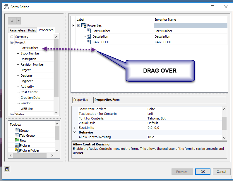

I would really like to see this added. I'd especially like to be able to use this in iLogic forms, so that I can control the value of an iProperty with my form rather than a Parameter.

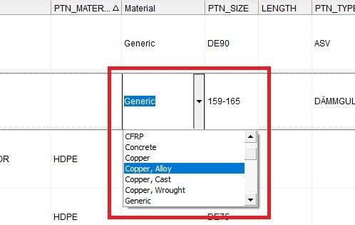

Would be great if we could pick the right value from a drop down list while filling in the iproperties. Would be a great time saver. (and still have the possibility to add something different too).
