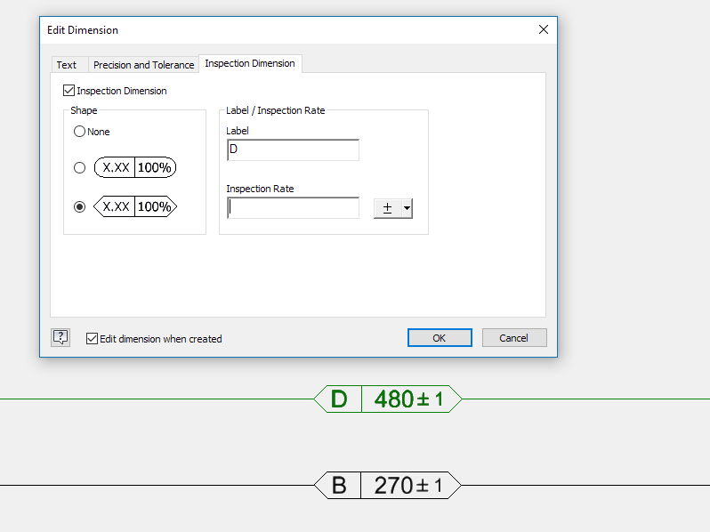

A welcome new feature would be to extend the current inspection dimension.
In the current dimension window you can only change the shape of the balloon, add a label and an inspection rate.
The disadvantage of this  is that it is rather far away, and not quickly editable. And that geometrical dimensions for example are not included.
Besides of that the colleaguees from the incoming goods inspection, don't have inventor. They have MS Excel thought. So it would be great if this feature was taken to the next level. With a quick acces option to simply add the inspection information to a dimension.
After clicking on the icon the user can select they way of numbering (Alpha/Numberic) and a default inspection rate. Then he can or select all the dimenions and add these properties to it, or he can select the dimensions one by one, asked to fill out the inspection rate.
There should also be an option to renumber the inspection dimensions. Start by #1 and every click on a following dimension increases the #. (Like AMD ballooning; maybe a idea for reballooning in Inventor also).
Finally a table can be created with an overview of all the inspection dimensions, with the tolerances intergrated and inspection rates included. This table should be exportable to MS Excel, maybe even with a conditional formatting when the later measured dimension is added, the cell will color red/green.

It seems to me that all this would require is the ability to create a table of dimensions that have been designated as inspection dimensions in an existing drawing feature as seen in the screen clip below. The fields already exist so it's just a matter of building the functionality to include them in a table.
