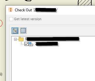

When checking out assemblies from Inventor, with multiple parts and sub-assemblies, typically, logically organised by folder; they appear in the dialogue box as a long list with tick-boxes next to every file; and collapsable folder node check-boxes.
It would be a game changer, if the folder nodes also had tick-boxes that acted to select and/or deselect multiple files with a single click!

Using Inventor 2022 and Vault Professional 2022.
If I use the Check Out command I see something similar to your example.
If I use the Get Revision command, I see the nested folder option that you want.
I would like both commands to have the view options of the "Get Revision" command.

I am guessing you are achieving that via Vault Pro?
I am only using basic Vault and do not think it is an option.
