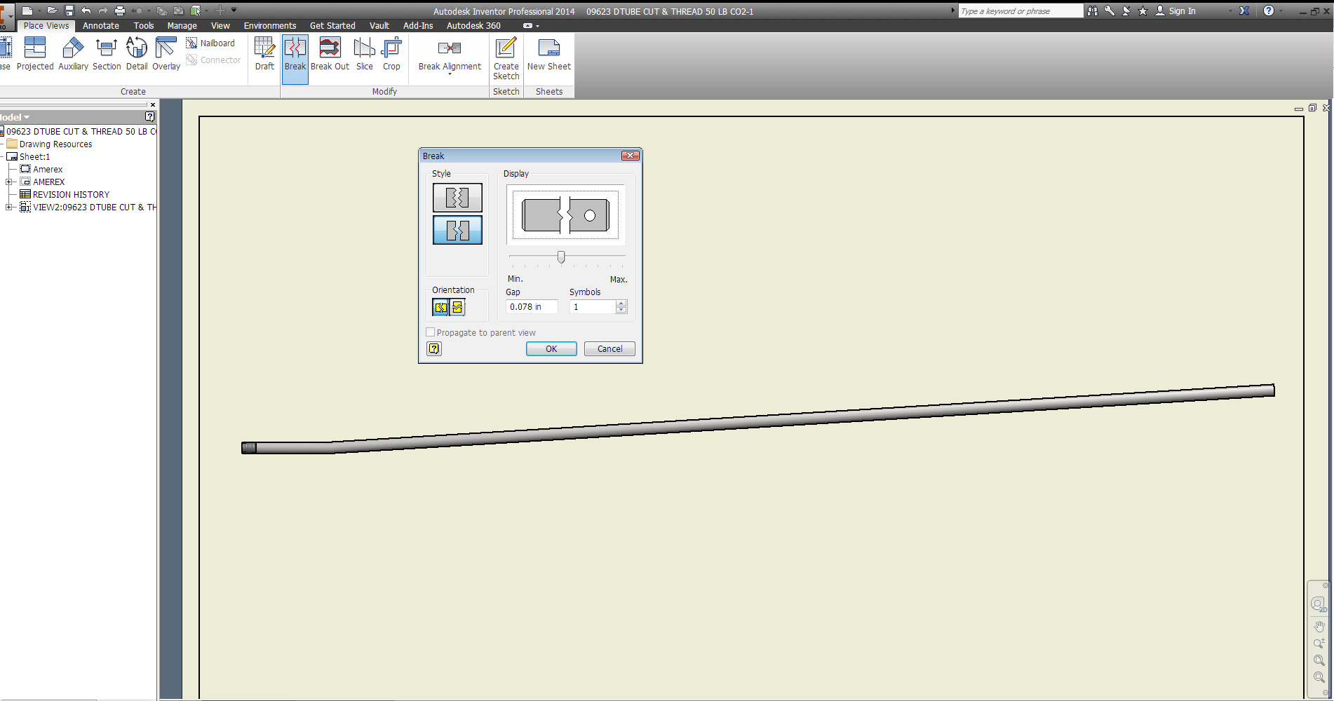

Ever had a drawing where you wanted an aligned to edge orientation for a break view? I have!!!
 If yes, please vote to add this simple yet highly effective functionality I feel has always been missing.

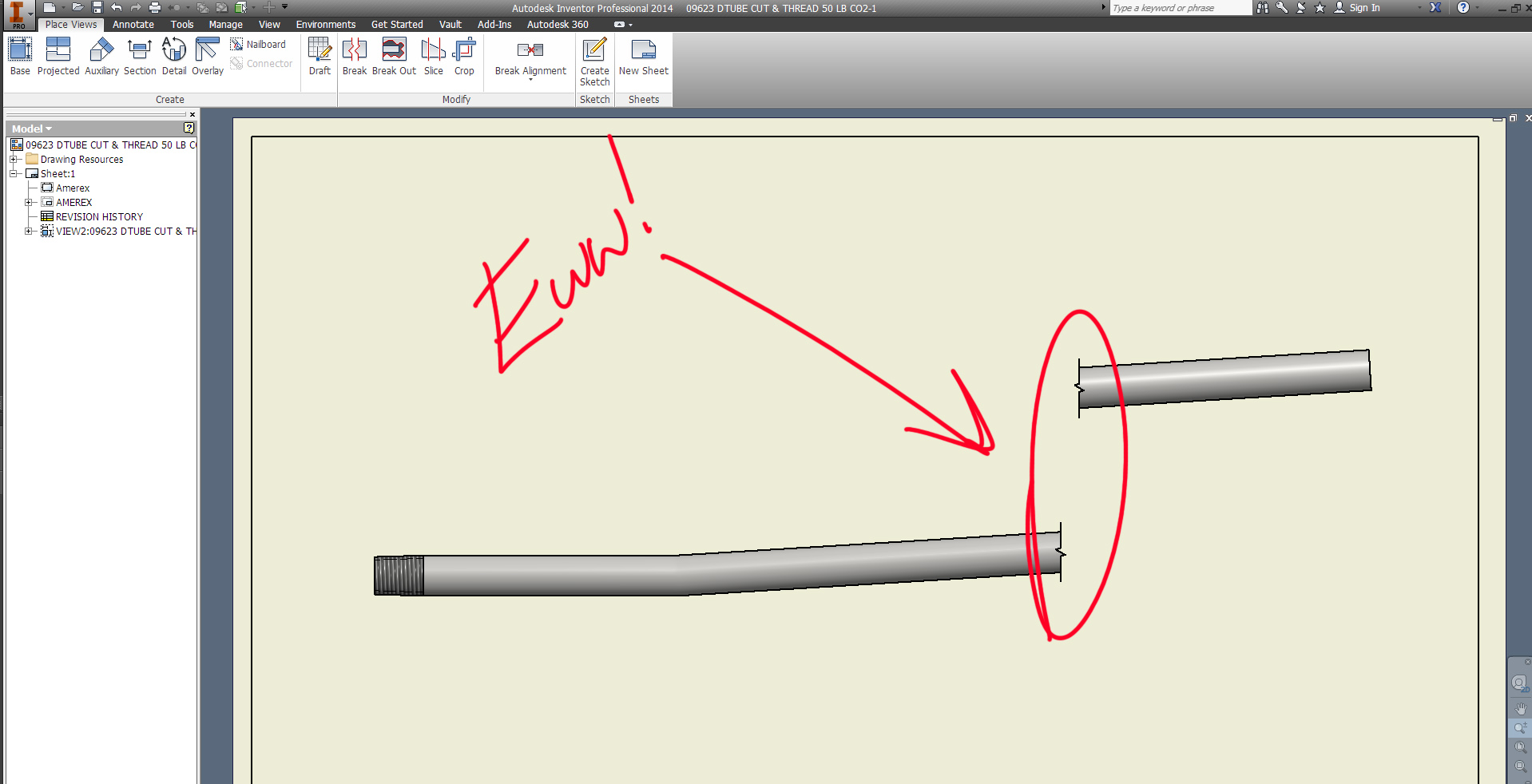

Example. Bent piece of pipe that I wanted to put on a B size drawing and in full scale. Can't use the Break tool on the bent section and keep the break aligned how I want it due to limitation of only Vertical or Horizontal Break orientation....
Result of horizontal break. Not nice to look at in this case is it?
My proposed fancy new "Aligned" orientation button....
You would use Edge selection to select the edge you want your Break to be perpendicular to (or possibly ability to edit the Break properties at the sketch level?).....
The end result would be a MUCH nicer and desired result....

When using Break on a drawing view, you have horizontal and vertical as orientation options.
The wish is to have more orientation possibilities like 45 degrees. Ideally to have a field to put any angle value.
This is useful if you design staircases for example

I would like the input to be linkable to a model edge. I sometimes want this for auxillary views of long sheet metal parts.
I agree with both. Have the ability to select an edge like Aux View and have an input box for exact angle. Wish I could give this more kudos.

Instaed of a new feature way don't you make the long section you want to break in the horizontal?
kwilson_design
I can't do that due of a dimension from the bottom of the theoretical floor to the top edge of the angled pipe. It is a reference dimension they use out in the shop floor to easily check the angle of the pipe. If I lay my angled section 'flat on the ground' then that dimension is not possible to measure on the drawing. Also there are times where the geometry is more complex than a pipe and simply rotating the view is not an option.
Instead of creating yet another Inventor work around, which takes more time for setting up views and in this case wouldn't work, why not allow for more flexibility? Why do I have to be limited to horizontal and vertical? Why can't I have the ability to quickly create views without jumping through hoops? I think those are better questions to ask.

Thanks for your input. Take a look at the below example images. The break appears misaligned in these cases and not very attractive to look at. An aligned  break in these types of cases would solve this issue. No matter which way you rotate the view in this case, you would still end up with a misaligned break view.
Horizontal break...
Vertical break....

But that is the way it is suppose to look like sheet 1 in your post.
Sheet 2 come on that would never be done we do have to be realistic.
 I Also I do not see how they would handle the dimension for that improper break. Because that way would not hold a true representation of the part. I am sure they could figure it out with a few bugs.....
This to me would be the same as overwriting dimensions in Autocad a big no no..
