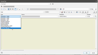

The 2025 release of Inventor added the ability to reference part list properties in text boxes (general notes). This is VERY useful for drawing notes that reference item numbers, part descriptions, etc. so that they auto-update if additional parts are added to the BOM or if things are otherwise moved around.
Where this falls short is when you want to do the same thing with the leader text. For some reason, the same functionality was not implemented in the leader text tool. It would be fantastic to duplicate the ability to reference part list information in the leader text tool.

This is the first thing I noticed when they implremented it because most texts where this feature becomes handy are leader texts. I'm kind of surprised they only did it for regular text.
I would prefer "Text" and "Leader Text" would actually be the same thing. Want to add leader later, no problem. And the leader could have same option as "Sketch symbol" to make it hidden instead of deleting it. This way you can always see where it is attached when you move the text.

Completely agree with the comments here. This was a great feature to add, but it was half baked in only adding it for text boxes. This needs to be added for leaders and realistically anywhere you would put text on a drawing, like weld note tails or dimensions. We often reference PC numbers in weld tails to describe if a certain PC needs to be welded before others. Or to make it clear a dimension is the length of a PC instead of a different dimension.
Hard to believe this feature was added over 2 years ago and we still don't even have the leader note ability yet, let alone everywhere on a drawing.
