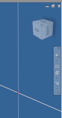

I can't tell you how many times I have fallen victim to this issue. You are square to the view (as indicated by the cube) and one would think that if you wanted the peak points in line you would hit the horizontal contraint.  No, because this view is not normal for the default sketch, meaning the sketch rotates (see my other idea about non rotating sketches 180°) this view does not become the norm.  Thus, because of this factor, the vertical contraint is needed as apposed to the horizontal.  I found this out, because when I selected the horizontal, it made my sketch really funky.  Not sure what the solution would look like for this, but something needs to be done to make the difference between the two more clairvoyant.
Tags (1)
This has happened to me so much I have given up using horizontal and vertical constraints for the most part as they are so disfunctional. This should be fixed, it works in OtherCAD so this is so basic it should work here also.

No, it shouldn't ever be dependent on the view orientation ... but that's not exactly what I took away from the OP here.  What I got from it was that horizontal and vertical should be tied in with the view cube.  If you're on the XY plane, then horizontal and vertical constraints match the view cube's lettering.  We read (in English anyway) from left to right, and that's horizontal.  The up-and-down direction of the letters on the cube matches the vertical direction.  Same if we're looking at XY from the back, or if we're looking at XZ from the top or the bottom.  When we look at YZ, though, horizontal and vertical don't match the orientation of the lettering on the view cube.  Horizontal takes us along the Y axis, and vertical along the Z.
I would like to see vertical be parallel - always parallel - to the Y axis, and horizontal be always coplanar to XZ, no matter what.  (Unless you are sketching on the XZ plane or a plane parallel to XZ - in that case vertical should be parallel to the Z axis, and horizontal should always be coplanar with XY.)
LT.Rusty
Neil,. while I agree with you that they are a little counterintuitive and I'd like to see them get a bit more rational, there IS a not-obvious way to tell what's going to happen when you use one or the other.  In the screenshot above, notice how the major axes are turned on in the sketch?  Notice how one of them is thicker than the other one?  The thick one is always the horizontal direction, and the thin one is always the vertical direction.  It's not an obvious cue at first - I only discovered it a few months back after JD Mather beat me over the head with it when I was complaining about the same problem.  🙂
