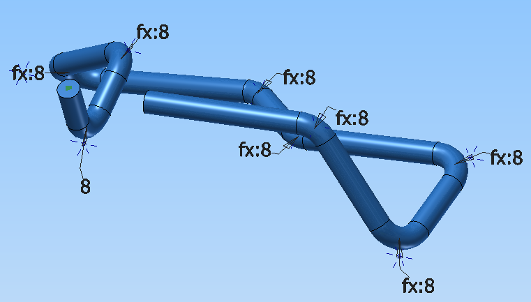

Any easy way to change a thrid party's .stp files radii without remodeling the whole file/part?

No the diameter is correct. I need the bend radii on the corners to be 8mm
ctr not 12mm

JDMather
@Anonymous wrote:
yes I would any help would be greatly appreciated
Nick
What version of Inventor are you using?
Maybe something like this (see attached)?

CCarreiras
Hi!
I prefer JD method, but if you are not confortable with 3D sketch, you can do it with 2d Sketches, but will give you more time to solve.
